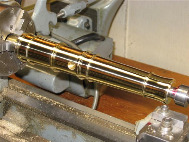

Started on my version of a Naval 24 Pounder. Barrel is brass 9 1/2" X  1 5/8" dia. with a 1/2" bore which

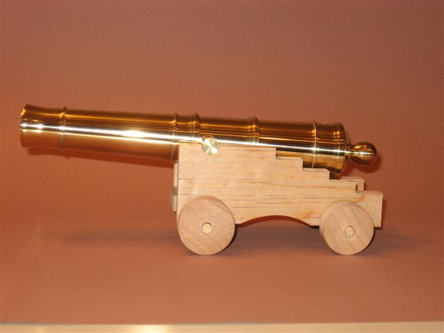

I made on my 9" South Bend Lathe. Mock up pine carriage and wheels to get my proportions right for
"the look" I'm after. Finished carriage will be Cherry or Rosewood with brass wheels and axles with Cherry or Rosewood inserts.

Did the steps on the back of Naval Carriages serve a purpose and is there a name for them?

I don't know what the steps are called, but they're there for a reason. You set a handspike across the step in the cheek, with the end under the tube, to raise the breech of the gun and adjust the quoin.
The multiple steps give you a better range of adjustment.
Smaller guns could possibly be wrassled up by hand, but raising the breech on a 24-pounder is going to require some leverage.

Thanks again for the compliments and the answer to my question regarding the purpose of the steps on the carriage. I had a feeling that's what they were for but never saw anything in print.
