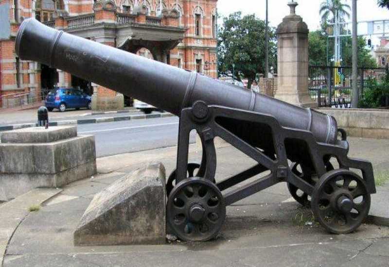

« Reply #10 on: March 30, 2009, 09:31:58 AM »
Iron Garrison Standing Carriages were made of cast iron & were used in place of wooden carriages which were then stored away. The cast iron carriages were perfectly capable of being used but would shatter if hit by a shot & so in times when conflict was possible the wooden carriages were taken from store & brought into play. With the 'arms race' guns eventually became too heavy for wooden carriages to be practical & so iron carriages were used, on traversing slides/platforms etc. These later carriages, introduced in the 1860s, were constructed of wrought iron.

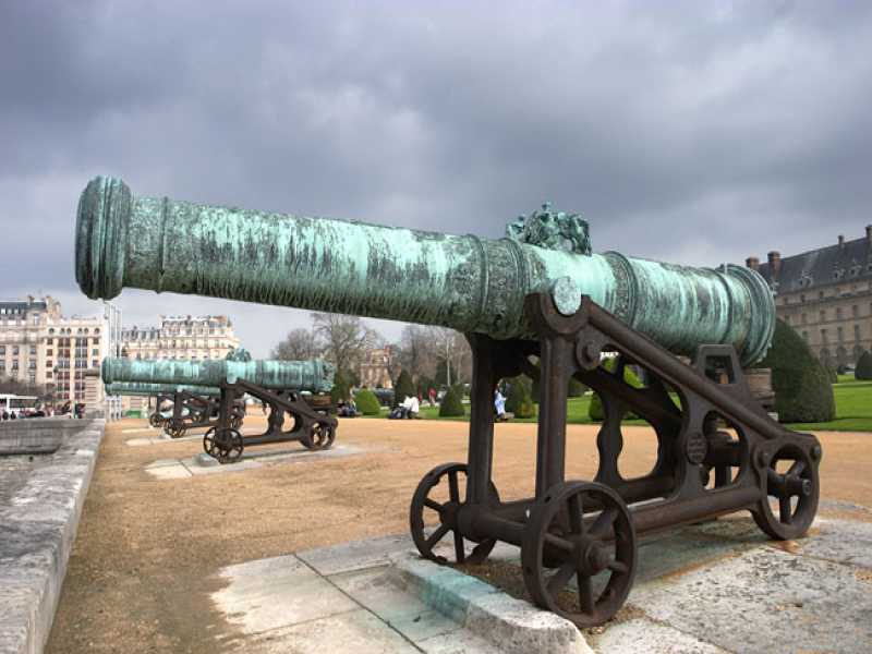

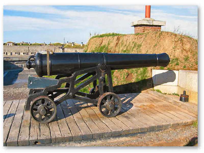

« Reply #11 on: March 30, 2009, 12:11:30 PM »
This is basically just a reiteration of Adrian's post, but I think that it's also true that quite a few of the examples of this type of iron garrison carriage that we now see dislpayed are contemporary reproductions that were chosen for aesthetic reasons coupled with their being less costly than some other choices, even though they sometimes don't match the time period of the guns mounted on them.
 http://samilitaryhistory.org/vol036dh.html
"As will be described shortly, our gun came ashore in Natal after its naval service. This explains the iron garrison carriage on which it stands. Guns of the period were mounted on field, siege or garrison carriages. These latter, being made of cast iron, were liable to shatter if hit by enemy fire, so they were not used in action. For every iron garrison carriage, a wooden carriage was also issued, and these wooden carriages were used in the event of war. The wood used was elm, which did not splinter if hit. Ships’ guns were normally on wooden carriages.
The use of wooden carriages for land service in wartime is shown in illustrations of the war in the Crimea. There are several good prints of muzzle loaders on these carriages in action during the siege of Sebastopol.
Wheels less than 20 inches (51 cm) were called trucks. The Pietermaritzburg gun is on iron trucks. Ships’ guns were on wooden trucks. These avoided damage to the decks, they were lighter, and they were easier to repair.
The weight of this carriage is inscribed on it thus, ‘16-2--0’, which signifies 16 cwt 2 qtrs 0 lbs (838 kg). The equivalent wooden carriage weighed 11.5 cwt (584 kg). Disadvantages of these heavy iron carriages were the difficulty in elevating and traversing, and the difficulty of repair.
‘No 21’ may refer to the type, or the serial number of the carriage. The designation ‘12 pr’ appears on the side frame, and also on the transom (joining the two sides). The arrow denoting Government ownership also appears on the transom beneath the breech.
Note that there are no cap squares holding the trunnions in place. They rest in deep housings, and the weight of the gun made it impossible for it to jump out on being fired. A 12-pounder smooth bore should not be compared directly with a 12-pounder breech loader, but nevertheless it is interesting to note that this smooth bore weighs 32 cwt (1 626 kg), compared with the Boer War Royal Horse Artillery’s breech loader which weighed 6 cwt.(305 kg)".
The photo above is of the Halifax, Nova Scotia 'Noon Day Gun', but it would be very similar (it is a British Blomefield pattern cannon) to the gun and carriage described in the South African Military Historical Journal.
Cannons along the Seine in Paris, France.

« Reply #14 on: March 31, 2009, 12:00:32 AM »
I'm going to take an educated guess that the carriage posted by DD is made of cast iron, with the sideplates each cast in one piece.  I'm getting the impression that a wrought iron carriage would use smaller parts bolted or riveted together.  I think that's one way you can tell if these are cast or wrought.
I was thinking the skeleton carriages posted by BoomJ and DD were made from the same pattern, but closer inspection reveals some minor differences, so they are very close but not the same design.  The DD carriage seems to have an extra vertical support about 2/3 of the way back, or if the other has one also, it is in a little different location.
For wrought iron, you need fairly massive machinery to hammer-forge the hot metal into a particular shape.  Given the size of the sideplates on this, I'm guessing a die or hammer face the size of the whole thing would be ridiculous, so I'm left with cast iron as the only possibility.
The US mortar and seacoast gun carriages of the Civil War are kind of an exception as they used large plates of wrought iron, say 1/2 inch or so thick, and there must have been many ironworks in the US that were capable of producing that by the end of the Civil War.

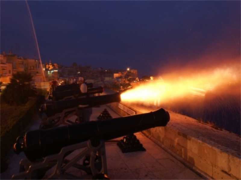

Lance,
 This is a photo of a 24-pounder smoothbore mounted on iron garrison carriage firing a salute at one of the British forts on Malta. These carriages were made with the intention that cannons mounted on them would be fired. I also think that Cannonmn is probably right in that these types of carriages placed in certain settings, like these on the parapet of a fort, might have indeed been intended for use in battle.
http://www.wirtartna.org/od_menu/SalutingBattery/tabid/259/Default.aspx

« Reply #26 on: March 31, 2009, 04:29:40 PM »
 Boom J, That's a better picture than mine and makes the case even stronger they were used in battle. It's just a guess on my part,but i would say the one in my pic was used until it got knocked out. Thanks for sharing.
