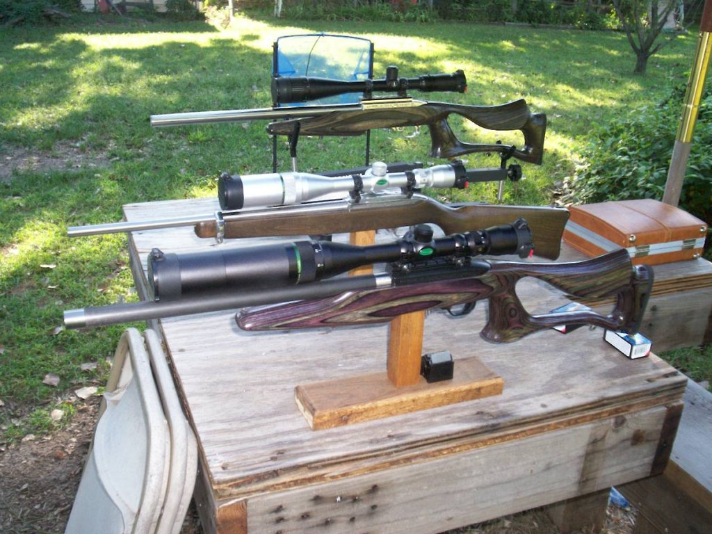

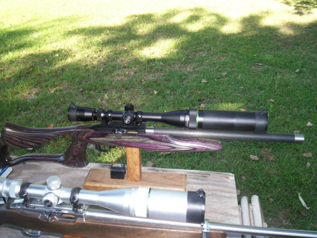

Offline Smoke-em
  • Posts: 16
Re: 17 mach 2
« Reply #2 on: September 19, 2007, 01:05:35 AM »
Here is a picture of my conversion.
I really love the the rifle and the little .17 round.  I even stopped shooting my .22 calibers.  I have not had any issues with mine at all.  since you are a rim-fire kind of guy I am sure you love creating the gun, and then shooting it.
