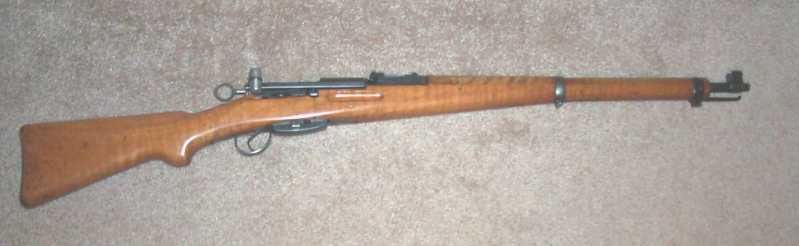

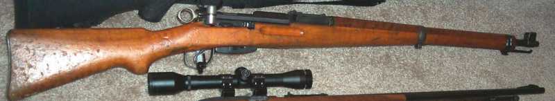

OK, here's my  walnut stocked Swiss K31 as I received it and after I steamed the dents and put a few coats of tung oil on it.  I thought it was a shame to keep the nice wood covered with that "original" orange shellac.  It shoots as good as it looks.    I scoped a beech stocked k31 for my hunting milsurp.

YOU CERTAINLY DID A NICE JOB, JAMES!
