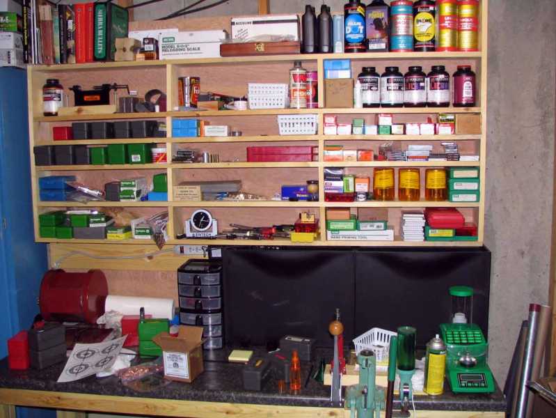

My loading bench
« on: July 16, 2007, 08:32:53 AM »
My loading bench. It needs cleaned up ::) and I am going to have to expand. ;D I am just running out of room. Any suggestions on how?

 you COULD send all that junk to me and start over!! Or maybe move into the wife's sewing room!

jhalcott - Thanks for the idea hardy-har-har ::) I have accumulated a bunch of stuff over the years :o I like a clean bench and have to find a way to store this stuff. Not all of it is in the photo. It is all valuable and indispensable. ::)

 Here's what I'd do.  Go down to the lumber yard, buy a bunch of wood, screws, etc., and the GET BUSY!!!

I bought a couple Stanley cabinets at Home Depot.

Yup, get busy!! 1x6s and shelf brackets are not expensive and easy to install, I made room for a bunch of stuff with simple shelves around the room.

Thank you guys ;) My bench is 6'. It is a kitchen counter top and I have made it just the right height to set at with a folding chair. It still is OK to stand to if I have a gun in a cradle for repair or cleaning or removing/installing a barrel for a bolt gun.  I have holes drilled in the front 2X4 to mount things on, like a case trimmer and a barrel vise. BTW the two big black things on my bench are full of cleaning supplies. I have thought of adding more bench space along with the storage. You guys have given me some good ideas. I am now thinking about those bins that hang on a rack too. I think I am going to add shelves to the wall and possibly add a cabinet. I sure would like to add some counter top space. If there are any more, please bring them on. When I get it done, I will post a picture or two.

Storage!  For years I've recommended new guys build three times as much storage as they think they might need, and to understand that eventually even that won't be enough!
My best storage areas are "book shelves", made no more than 8" deep but as wide and tall as I have space for.  Wider shelves allow me to loose small stuff too easily!  (And I like to paint my shelves white, to help me find small items that might otherwise get lost.)  It is important to anchor such shelf units to a wall to prevent tipping.  Those shelves I want to protect from dust get simple 1/2" plywood doors hinged from the up-rights.
I find that long plywood shelf boards are prone to sag so I only use 3/4" solid boards, usually (so called) 1x8 pine (actually 3/4" x 7 1/2"), and no more than two feet wide per unit to prevent sagging under heavy loads of bullets, etc.  I attach cheep 1/8" white hardboard or paneling to the rear for lateral stability.
Shorter book shelves can be attached to a wall, say three feet above the floor, to leave the floor clear for boxes of other stuff.
These simple shelves are strong, easy to make and pretty cheap too.

I would like to thank all of you that contributed ideas and pictures. ;) It gave me inspiration. The bench is now cleaned off, except the scale. I do not use it any more due to my ChargeMaster 1500 ;D. I had it out to take pictures of an idea I had that will be in another post. I have plenty of room to grow, and I am more organized.  :o

Nice work, looks great!!

Thank you very much Tim ;D I really do not like a cluttered bench and I like to know where everything is. I have plenty of room now and should serve my need for a long time. I am thinking about getting a Redding T7 to replace my old Rock Chucker.
