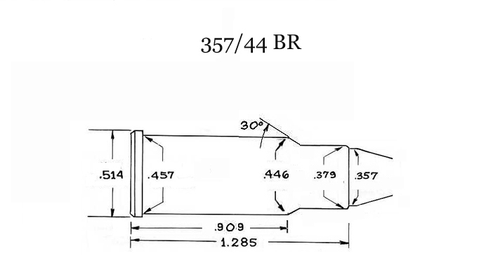

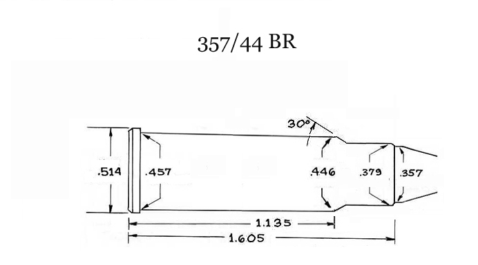

Offline briannmilewis
  • Trade Count: (11)
  • Posts: 1017

« Reply #6 on: December 15, 2010, 08:48:43 PM »

Re: 7.92 X 33 Kurz, Anyone got any ideas ?
« Reply #7 on: December 16, 2010, 12:11:17 AM »
    Brian,      Looks like your using a different rimmed case. The longer one could be made on 445 super mag and the other on 44 mag cases.
   The Kurz has a base dia. of .470 and is rimless, very similar to a 30-06.      Jed
« Reply #8 on: December 16, 2010, 03:03:02 PM »
Jed, yep, I was just thinking of alternatives, especially with cheaper brass of the 44 Mag.
