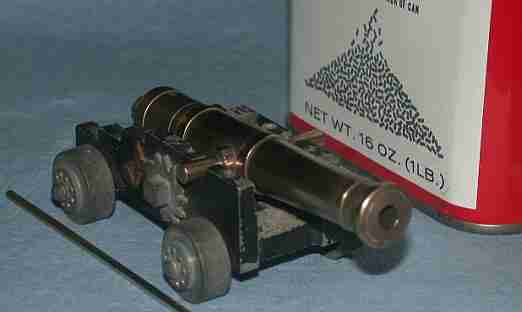

Other than the "bamboo wrapped with mechanics wire, loaded with homemade powder, and fired out of a bunker of fire brick cannons", the photos below (I hope) show the first "real" cannon I made.
It was made in high school on a 9" Southbend out of brass. It is aprox .190 bore, .64 at the breech, and aprox 4" long. The trunnions are press fit into pockets, the rings over the trunnions are contoured to the barrel, then whole mess was soft soldered together. It was originally bored to shoot some lead shot that Pop had, he also supplied the iron wire for the bamboo cannons although he didn't know about it at the time. The shot is long gone and I fire blanks out of it now on the 4th.
The carraige came off a toy cannon and is metal.
Note I have included the "required" powder can...

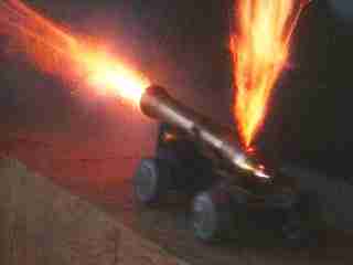

I believe it is also "required" to show fire and smoke...

Welcome Mike glad to have ya!!   Smoke and fire as well as powder can not required, just strongly encouraged.
Nice looking gun you got there!!!  How long you had it, must be a while since to build such a thing in school now would be a heineous crime.
.190 is BBB shot size.  Look around for shotgun shells for BBB shot.  Might even be somebody here who has some to send you!

Could also use 3/16" bearing balls if available.

Thanks for the welcome.
I turned that barrel in about 1970, Metal shop teacher even approved the project. As I remember he did suggest that I not proof it at school however. I use to shoot shot in it but it fouls so fast that I just fire it on the 4th for old time sake. I have a little bigger one just like it, I'll post some pics later on.
