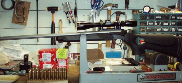

I'll second the Burris Signature Zees, as Dave said, they work excellent, won't cause ring marks and don't require lapping. I replace the cross screw with socket head screws, I broke a Burris screw once tightening  it, so I don't trust them any more. Burris replaced the ring set, so I ended up with an extra ring which I put on the Encore barrel. They seem to be in short supply now, but Midsouth has the best regular price on them at $28, Midway has em on sale a couple times a year at $25. My 375H&H PH barrel has a Leupy VX1 4-12x40 mounted in mediums, there's sufficient clearance at the hammer for use without an extension.
