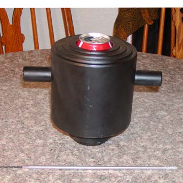

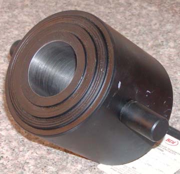

 Well I at least figured out  how to link my pics finally, It isn't the nicest looking piece but not bad for not having any idea what I was doing. I figured out what it is though. It's a little Dictator! Sorry no powder can yet. Ill try to get smoke & fire soon! I'm going to try to make a heavy metal Dictator base for it. Have a good one folks.

Interesting.  Kind of a Model of 1861 style mortar.  I would have made the trunnions half as long and twice the diameter, though.  Kind of like this one.

« Reply #13 on: June 15, 2007, 12:23:26 PM »

I wouldn't make any changes unless the trunnions prove to be inadequate in strength.  But the info is out there if you want/need it.
That one is bored for 2 1/4" round shot to use the same shot as a 2/3 scale Napoleon.  It is based on the 8" siege mortar; the wall thickness is a little too much proportionately.  The overall diameter is 6" so the bore should be 3" instead of 2 1/4".  But it is an interesting alternative to the Coehorn and M1841 styles that are most often seen.

I guess I'll find out soon enough if the trunnions will hold. I think the 4th of July will be fun again , I'm looking forward to it like an 8 year old. Thanks for your input and the link. M223

Keep the support for the trunnions close to the tube and you have much less potential for bending.
