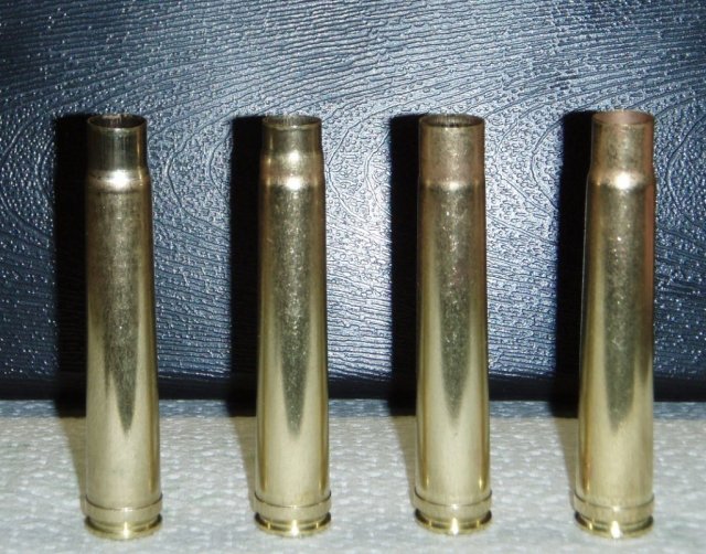

If it's not defective primers, seating hard into the lands from what I've researched works sometimes, but forming a false shoulder on the case and then neck sizing it to desired headspace should solve the problem. For the Whelen, I'd run the brass onto a .375" expander, then neck size, IE: partial full length size, accordingly, see if that eliminates the problem.
The pic below is of .375H&H brass, used a .405" expander on it.
Right to left, Factory brass, expanded neck, partial neck sized, final neck sized.

I'd get a Redding tapered .375" expander for your sizer die. A standard sizing button will work too, the tapered just works easier. Just remember to remove it once you do the expanding. This is a one time thing, once the brass is fireformed to your chamber, the problem is solved, until you buy new brass, anyway. ;)
If you have any .375" die set like 375H&H or 375 Win, they should work too, I use a .30-06 die set to expand .280 Improved necks for fireforming.

That's the idea, you'll gradually adjust the sizing die down into the press until the newly formed shoulder is low enough to just chamber the round.
The 9.3 isn't enough, you're only increasing the inside diameter from .358" to .366", I don't think that would create a very good shoulder, but the 38-55, is .377", so it should work fine, just be sure to lube the inside of the neck good, I use Hornady One Shot with no problems. Dunno if you have nickel brass, but it doesn't work, I got split necks trying to neck up 30-06 to .338". :-\
