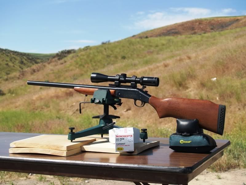

I went shooting today.

And next time try with the rest under the receiver, this really helps out a lot in my, and most others here, experiance. I like Caldwell bags for this as the receiver sinks in snug.
Keep up the good work. It will tame down.

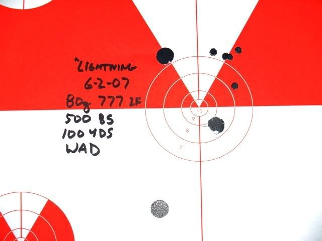

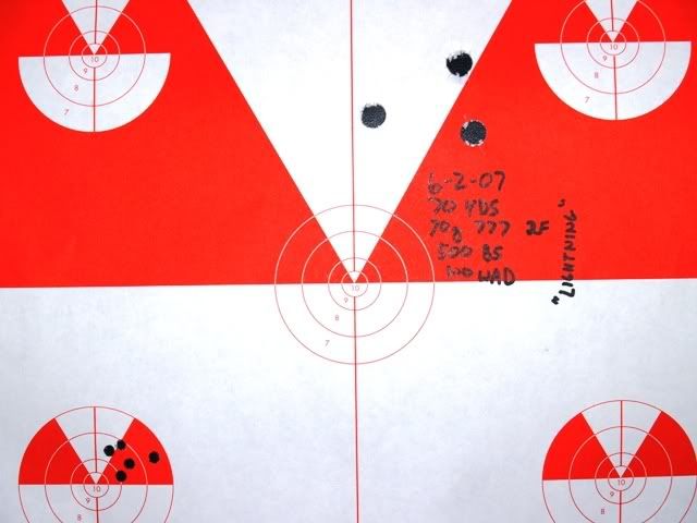

Well, I thought I would bring this thread back to life, so there is a little background on the gun.
Haven't been shooting much, just been too darn busy.  Did sneak out a couple weeks ago and shot the 223.  Pretty much the same exact results as today.
Today I also took my new muzzleloader.  It is a White Lightning, .50 caliber.  There were only 2000 of these made.  They were all made in 1994 and all sold in 1995.  I happened to find a new unfired gun that a guy had been sitting on.   It has a 22" barrel and weighs in at 6 lbs 5 oz.  Packs a nice punch for recoil, but sure will be nice to carry come hunting season.  Will also put a Williams peep sight on it one of these days.
For now, the 223 has settled in to shooting about 1 1/4" or less groups at 100 yards.  If I lay the groups over the top of each other, they are very consistent.  Some day I will strip the RTV out and redo it and make it a little thicker.
