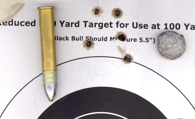

Today the winds were gone so I loaded up 20 rounds and headed out to the range to try my selected loads.    75 grains - volume - 55 grains weighed of Pyrodex RS  with my 20:1 cast lyman 457677 bullet, weighing 490 grains, and lubed with my secret sauce.  I also add a .09 lube disc and a .06 over lube wad along with the .03 over powder wad.
I discovered by accident that I get better accuracy if I shorten the bullet length from what is shown in the picture.  It seems to shoot better if I lower the bullet one more lube ring.  The below picture show four shots at 1 1/2 " with the fifth shot opening the group to 1 7/8".  The group was shot today at 186 yards which is as far as I can shoot at my range.  I again used my 3X William Malcom 3/4" 3X scope.  The cartridge that I shot is on one side, and a bullet recovered from soft dirt is on the other side.
The rifle used is a Pedersoli 34" barreled 45-70 1874 Sharps weighing 13.5 pounds.  And yes, I did use a blow tube.  Using a PACT Chronograph, the bullet flew at 1320 (avg) fps and dropped 15" from a 100 yard zero.
