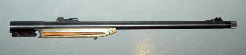

I added a front & rear tru-glow type sight to my turkey barrel.  I basically sketched the outline on the barrel, and then roughened up the surface of the barrel with a dremel tool.  Then I used a 2-part epoxy adhesive (don't remember the brand name, but the type you can buy in any hardware store), and epoxied it on.  I allowed it to cure overnight, and then post-cured it in an oven at 100C (212F) for 1 hour, which optimizes the adhesives properties.  It's been 2 years with no problems at all.
I have been wanting to do something like this to my turkey barrel, I just wasn't sure how.  I have been following this thread with interest.  Where did you place the rear sight, on the chamber or just ahead of the chamber where the barrel tapers down slightly?  I would want to make sure that I had the correct height front sight, because once epoxied in place, there would be no replacing it with out destroying it.

« Reply #12 on: April 26, 2007, 02:25:49 AM »
Here is a photo of my setup (I hope at least as this is my first attempt at posting a photo).
"They that can give up essential liberty to obtain a little temporary safety deserve neither liberty nor safety."--Benjamin Franklin Historical Review of Pennsylvania. 1759

« Reply #13 on: April 26, 2007, 03:39:16 AM »
It looks very good.  That is what I wanted to see.  I'll keep my eyes open for some sights and get them put on my barrel.
