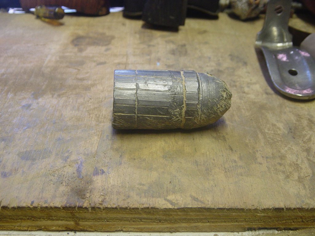

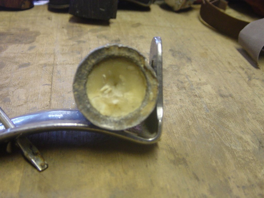

CrufflerSteve ,
   I am shooting a lead Read type hollow based projectile, filled with beeswax. The beeswax does not belt at all (fairly high temp anyway). Phot of the base of a recovered projectile showing wax still intact.
The wax acts much like the base plug used in the minie ball base of the Enfeild rifle. Plug moves forward to expand the projectile into the rifling. This projectile has a very deep hollow base. See how the lower band has expanded entirly into the rifling.
Fired from a fullsize 1.5 Ellsworth gun with 3oz. 1 f,  Projectile wt. 1 lb 5 oz.

Thanks guardgunner. I was wondering what the effect of the beeswax would be while in the barrel. From your picture its somwhere between a soft solid and a liquid during firing. That would help push the lead into the rifling.
I was worried about George's point. If the beeswax coated the bore, it would be a pain to clean and a nightmare with wax over BP fouling.
From your experience, it seems like beeswax might be very useful.

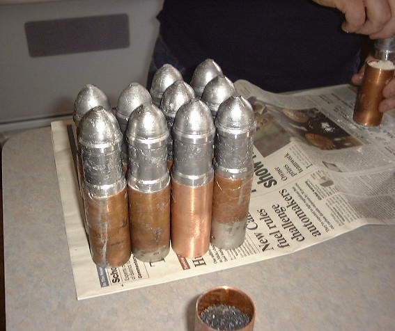

   Nope,anint got one...But ... I do have one of prepared cartridges. The hollow base goes all the wat to the upper band.

Those are some amazing projectiles, I would love to know more about them, their cannon and usage.  I want a gun that shoots something like that.  Please tell us more.  Is that copper powder cartridge reusable? I am just in awe.

 those cartridges and projectiles belong to a civil war infantry gun call and Ellsworth's gun. Try this link for more information.         http://www.nwtskirmisher.com/useful-extra4.shtml     and this link for history of the gun.             http://www.nwtskirmisher.com/useful-extra5.shtml
The copper cartridges (1.5 copper pipe with freeze plug) hold up very well. Ours have been shot over 10 each times without failure.
The original cartridges were brass but were one shot only.
