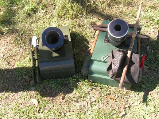

The Hern barrels are about 85% full scale based on their length.  In my opinion the full size bed is a little big for the Hern barrels.  It has a tendency of making the barrel look small.
Here is my 12pdr next to a Hern barrel.

Thanks for the replies Rickk and Cu. Cu is that a illusion or is the herns bore off center? Thanks for the picture of comparison, that really helps.

The bore is centered as far as I can remember.  I think it is an illusion from the camera and the paint job.
The Hern barrel is on a full size bed.  According to the ordinance drawings the bed should measure 31”x15”x9”.  I think the one was pretty close to that.
