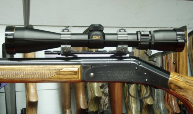

Re: first handi
« Reply #2 on: March 08, 2007, 05:58:48 AM »
I have a 3-9x40 Prostaff mounted in low Warne quick release rings, you'll need to trim the tip of the hammer to do it tho. Medium Burris Signature Zees will work also.
Offline Hunternz
  • Posts: 86
Re: first handi
« Reply #3 on: March 08, 2007, 07:44:14 AM »
Hi Tim,
surely that is not rust below the hammer spur? ;D, you are slipping.
Regards Howard.

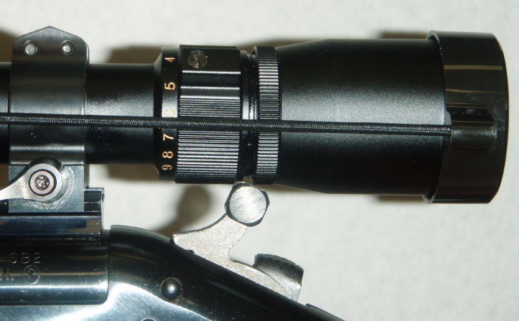

Re: first handi
« Reply #4 on: March 08, 2007, 08:09:53 AM »
No slipping Howard, just an optical anomaly!! :D Here's a closeup of the hammer clearance which there isn't much, but enough, it's kind of deceiving cuz the extension top is open which allows a bit of clearance that can't be seen from a profile view.
