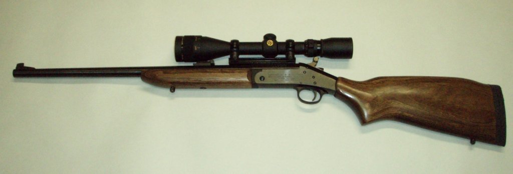

The top rifle in this picture has a simmons 3-9x40.
I was able to use medium rings and put the hammer between odjective bell and power ring.
I don't remember what brand. (Cheap)
