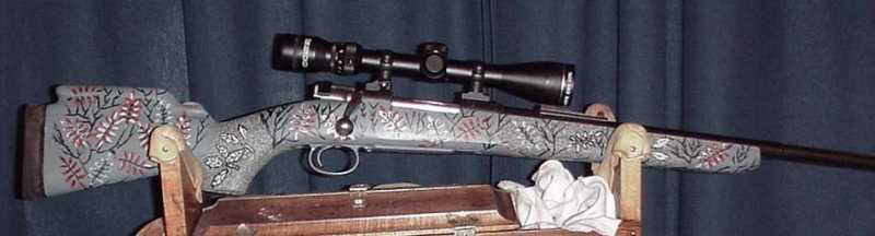

« Reply #8 on: January 13, 2007, 01:35:00 PM »
To remove the oils in my Swede stock I soaked the stock in the bathtub using HOT water and TSP soap powder.  Since I planned on cutting the stock down the minor warpage I got on the end did not bother me.  I did this twice and then cleaned the tub just to keep peace in the house.  After drying, I milled (using drill press and end mill) a flat spot behind the trigger guard, added a block of wood, shaped into a pistol grip then did the same on the back of the stock to raise it up.  After that I soaked the stock with diluted Formby's tung oil.  When that dried I use Krylon gray primer, then created a rough finish on the pistol grip and forearm using Plasti-Kote's "Flec-Stone.  Then using paint pens, created my camo, then put two coats of clear satin finish on.  Hopefully the pic will work.  Considering I live in an apartment, not too shabby.
https://www.gboreloaded.com/mhp/images/LostOkie66/swedewithcamostock.jpg
