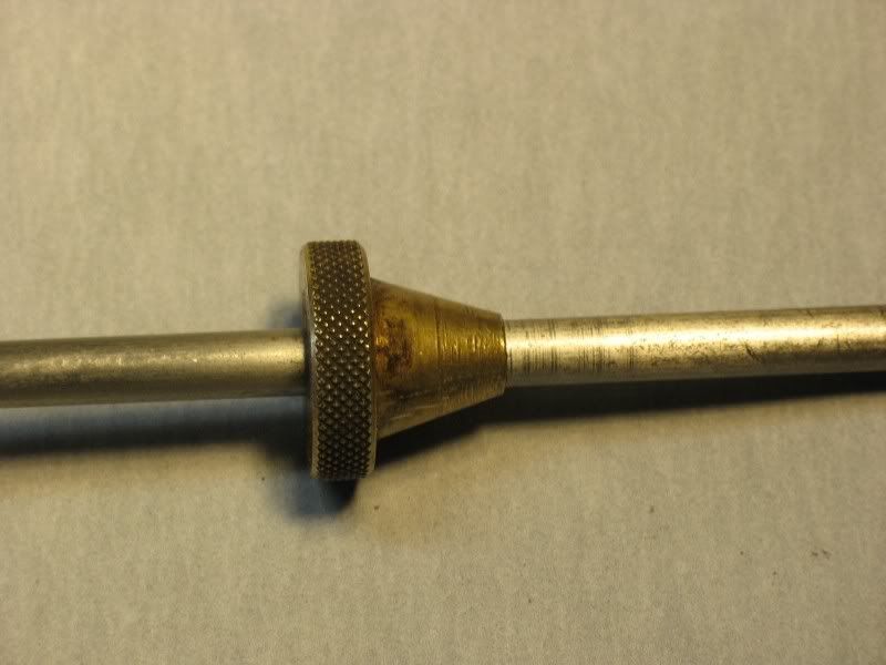

ML people use a brass guide and a stainless steel rod. The cone shape of the brass guide does work for keeping the rod from rubbing the muzzle. The brass is softer then the steel barrel, so it wears, not the barrel. The rod can be anything you want that will slide through the guide. , the brass guide fits everything from a 22 up to a 60 caliber. They are available at any on line gun supply place that carries black powder accessories, and can be bought by itself. Here's a picture:

Ummm... please read Rusty's post again, Chris. :D
Since Chris changed the subject,  bore guide info including a brass bore guide source can be found in the FAQ. ;)

Thought he was talking about dropping a rod down from the muzzle to knock a case out of the bore. I would want to use a longer rod then 8".... a real rod that I could push with and the brass guide to not rub the crown. Guess I need to talk a little more?
(oh Lordy, don't get him wound up again... he'll never shut up!)
Bore guides are handi. Now what do you use for blown necks that are left behind?
