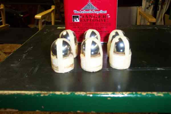

For a while I thought that I may have had it figured out.  Decided that I wanted to try some sabot mounted rounds in my 2 1/4" bore half scale Napoleon (Hern Iron Works).  Accuracy with a cast zinc ball has been problematic to say the least.  Noted that a 2 1/2" wood hole saw would cut out nice wood plugs just a bit over my bore diameter.  Could glue 2 or 3 of them together and then run a bolt down the center, mount in my 1950s vintage Craftsman drill press and sand them down to size.  A good idea anyway.... in practice they aren't what I would call square, instead they seem to lean a bit off vertical when set on a table.  So...... have a small wood lathe coming from Sears.  Should be fairly easy to turn them squarely then.  Once down to very slightly under bore diameter would be drilling a 1 1/4" depression for centering the ball on the sabot.
How to mount the ball to the sabot though?  Had thought of either masking or electrical tape but that would alter the outside diameter of the sabot.  Thinking of just gluing it to the sabot with either silicone sealer or liquid nails (or some other some such).
Any suggestions?  Thanks.

I use masking tape (1.5 layers) to hold the charge to the bottom of the ball in my Hern mortar (the charges are really light and it is hard to get them to go in straight any other way). The tape leaves the ball at firing. If you want them to separate, this may be a good way to do it.
If you want them to stay together, how about a drywall screw thru the bottom of the sabot and into the ball?

Have been using the wood sabots in my 1" bore cannon for sometime now. Very pleased with them. Accuracy is improved, and loading is easier. I use a large counter sink to make a divit for the ball, and 1/4" masking tape to hold it on.  Boomer
