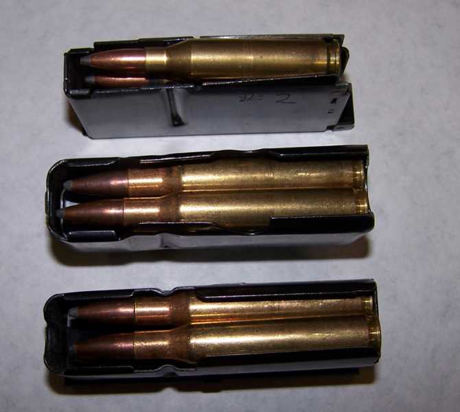

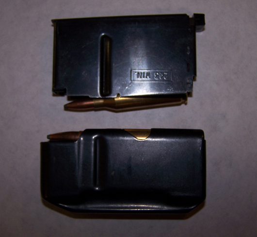

You might find that some bevelled strips glued or soldered into the sides of the magazine cases that just hold the shoulders back against the rear wall of the mag will cure the problem. This is a std feature on the old BSA and Parker-Hale rifles and stops the bullet tips beign mashed into the front wall of the magazine under recoil.
I am looking at the drop mag from a P-H 1200c as I writhe this and it has two indents running down the side of the magazine case walls the provide these shoulders to hold the case back against the read wall of the mag.. Just an idea  ;).
Edit:-
      This is the P-h magazine and you can see the impressed shoulders in the case:-
Hope that helps make it clearer.
Offline Siskiyou
  • Posts: 3417
Re: Remington 788 likely NOT to Make the Cut.
« Reply #9 on: August 30, 2010, 05:01:01 PM »
Brithunter:  Thanks for the post and the pictures.  Together they make good sense and it is a project worth trying.

I revisited the Remington 788 this week, and unfortunately the magazine did not feed the second round at the range the first time.  Accuracy is not an issue with the rifle.
I have followed up after your post examining the magazine.  The 788 magazine does have the indent/ridge designed to contact the case at the junction of the neck and shoulder.  I have included a picture showing the 788 magazine followed by a Remington 760 magazine, and a Savage 110CL magazine.
Note that the 788 magazine lacks the forward retention lips that the other two magazines have.  The forward retention metal (lip) keeps the case flat in the magazine.  The lack of forward lips allows the front of the cartridge to rise up in the 788 magazine.  When the front of the cartridge raises the rim of the case slips down in the rear a slight amount.  This happens on the second round because there is enough upward pressure to prevent it when the magazine is filled with three rounds.
I believe a secondary cause is a weak magazine spring.  I have two 788 magazines and they suffer the same problem.  When the top round is fed off the magazine it drags the cartridge below slightly.  When the bolt is brought back this allows the front to raise up higher and the rim to drop down.  When the bolt goes forward  over the rim and catches the body of the case jamming the rifle.
I am going to look around for 1/16 or 1/8 thick aluminum and create filler in the bottom of the magazine to increase spring tension.  I believe the real flaw is in the design of the magazine without the forward retention lips that the 760 and 110 magazines have.
