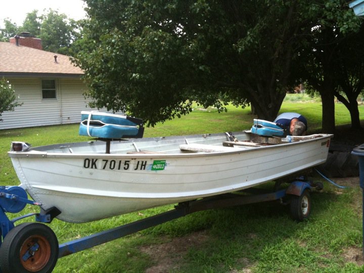

I bought an old v bottom boat last night that needs new wood on the bench seats.
They look like 1 by 12 boards with a metal brace to help hold the weight.
What kind of wood should I use?

It is an old knock around boat now but I want to fix it up a little. It looks like it was like this one originally.
http://farm4.static.flickr.com/3061/2742022197_1ddb7a8f95.jpg
So we have plywood or cypress.
Is there anything in between?
Something nicer looking and harder than pine but not special order prices.

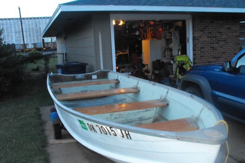

A pic for those that would like to see.
Offline PartsMan
  • Posts: 1351
  • Proud Handi Owner
    • myspace
Re: Boat seat wood
« Reply #17 on: July 22, 2010, 06:01:01 PM »
I went with Pine 1x12s.
Then added stain and polyurethane.
After
