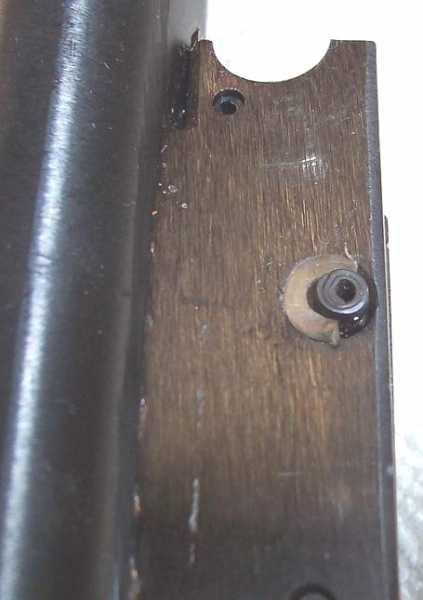

Can I convert a Ejector to just a extractor? I reload, and hate chasing brass when I forget to put my hand in the way.

I did the conversion/change per the faq's, easy with a dremel and file.
But's it's still a pita when I want to use my oal gauge for a new bullet, gotta use a C-clamp ta hold the darn thing in.

This is one of my Handis, a 30-30, purchased from another GBO member, with a modification similar to one mentioned in the FAQs. Only difference is the material used. This has a piece of rubber/plastic tubing set to stop the ejector from catching and allows the cartridge to extract with the spring pressure and not fly out. The case comes out of the chamber much farther than those in the newer style extractors.
Bill
