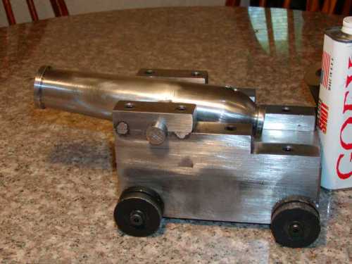

Well those of you who read my posts know by now I have zero woodworking skills, so I made a deck gun carriage entirely out of steel. It still needs cleaned up a bit and could use some paint. Total weight is 25 pounds.

WOW - that's one sure way to TAME recoil!

« Reply #3 on: July 13, 2007, 11:41:15 AM »
Tame recoil it will, but it will stress the trunnions and their joints more since they have to accelerate the higher mass of the iron carriage.

Well sometime this weekend I plan on testing the trunnion integrity. I took my time and built the weld up pretty good, also the wheels have good roller bearings in them. If the trunnions break I shall rebuild accordingly. I will try to get pics, but it isn't so easy to light fuse and photograph at the same time. Plus my camera seems to have significant shutter lag. Mostly I get smoke & no fire.   Tracy

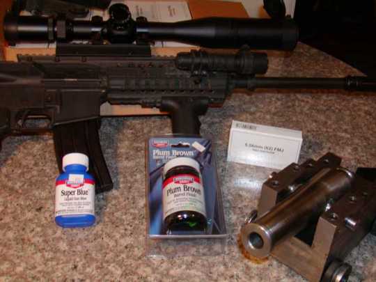

looks great Tracy, what do you think about bluing the tube and browning the carriage. you sure wouldn't have to worry about scratching paint off.

Shoot ya snuck up on me Lance. Ya that sounds great. Have you done any bluing and or Browning ? or is it best left to the experts? Tracy

buy a couple of bottles, directions on bottle, so easy even you could probably do it.

Tracy, i use Birchwood Casey products, i have good luck with them.blue it, wash it, steel wool it. if you want darker do it again.

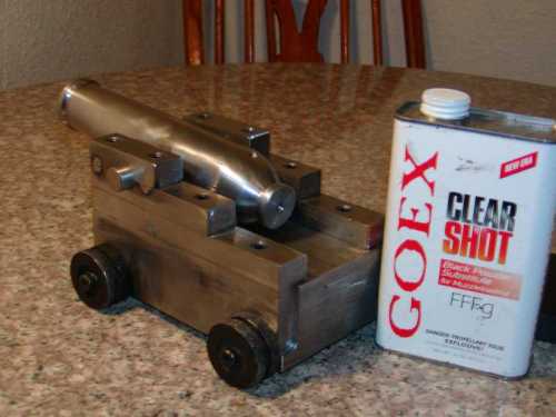

Thanks for your input D.D. I already got my steel wool, browning and bluing supplies. I am going to take off the trunnion caps and blue the barrel tonight. Sunday I will give the browning a try on the carriage. If I don't like it no big deal I will just paint over it. D.D. If I do paint it what color do you recommend, I am kind of partial to that Frazee Army green that Ggaskill used on his field carriage. Lance is this the stuff you were talking about? Please IGNORE the poodle shooter.  Tracy

hey Tracy, that's the stuff. super blue can streak, the perma blue is easier. super blue won't be so bad if your tube is polished really good. pratice on some scrap, or if you don't like your bluing job, it removes easy too.then you can blue it till you get it to your liking.

Streaky indeed, well it looks like I'll be redoing the bluing. Thanks for the warning on the super blue Lance to bad I started the process before reading it. Live & learn. D.D. the term mattie mattel  was coined when I was still in diapers. Some folks will understandably never forgive its early short comings. Now back to cannons. Yes D.D. I plan on taking off the sharp edges with a fatherless file. sharp edges tend to collect dings and shed their finish. Thanks for the carriage pics and painting tips. Alas domestic duties call phooey!    Tracy

Cold blue works better on warm to hot metal...

If your out there D.D. is it O.K. to put the metal in the oven on low heat after some bluing has already been applied, then when its warm apply more? I have about 8 applications on now and it is looking better. Just wondering if I heat it up and apply a couple more coats how that might turn out.  Tracy
Best way to apply heat is to leave  the barrel out in the hot sun.  You can also hold on to the barrel with your fingers adn warm it with a propane torch intil you feel the warm, but then you have to degrease where you fingers were..
Apply the cold blue with a degreased piece of 0000 steel wooll.  The steal wool will blue and react with the steel you are bluing.  By the way I use---when in America- Dicropan T-4  from Brownells www.brownells.com for my cold blue.
