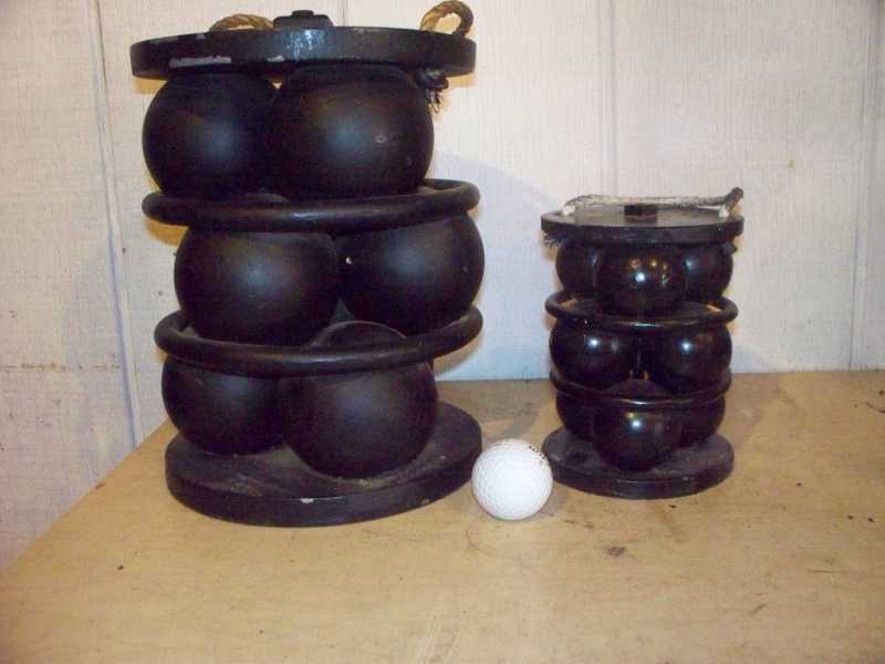

Eight inch grape shot without sabot and 12 pdr grape.  Each made as described in the Gibbon's Artillerist's Manual.  The 12 pdr grape was considered obsolete and had supposedly discontinued by the time of the civil war, but there are descriptions and photographs that would indicate otherwise.  Quilted grape was replaced by this style probably because it could be stored for long periods without the worry of having the canvas rot, and because this type is easier to assemble.  I prefer quilted grape because I believe it holds a tighter pattern, but given a choice canister is more effective.
