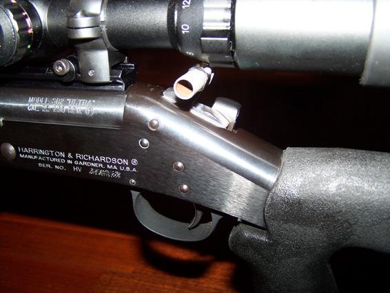

Made a “manual extractor notch”, as per Fred the Reloader and Wildcatter.
My Handi has a first generation extractor. I honed all contact surfaces, as Quickdtoo suggests for ejectors. Improved function.

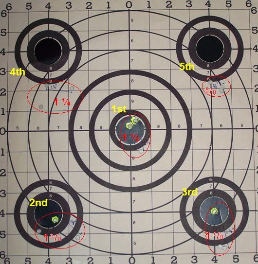

On 1/3/2010, the range reopened. I took the Ultra to “bore” sight the scope. The scope was off to the right approximately 20” @ 100 yards. I used the Burris Posi-Align® Offset Insert (± 0.20) to correct the deviation. I did not adjust for windage or elevation. Wind was less than 10 miles NNW. Downrange points due North. Temperature was 59 oF.
These are the results after sighting. @ 100 yards, Remington UMC JHP 50gr:
Keep in mind that in thirty years or so, I have fired a rifle once (about 8 months ago). It was a Marlin 336 (35 Remington), awesome classic! BTW, it was this experience that prompted me to get a rifle. However, cleaning the lever action prompted me to consider the sophistication of a “less-is-more” design, such as it is found in an H&R.
But I digress…
Back to my results. Perhaps not the most impressive; nonetheless, I’m quite pleased by them. The fun part is, of course, there is opportunity for “user” improvement, which I’ll be working on as the year progresses.

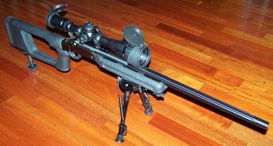

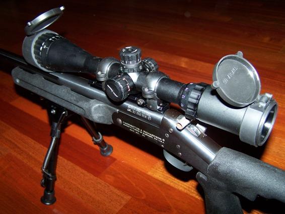

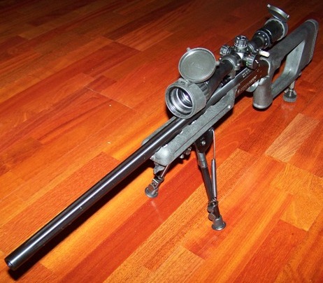

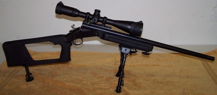

Here are some pictures of the finished product:
Customized weight: 10 lbs, 10 oz.

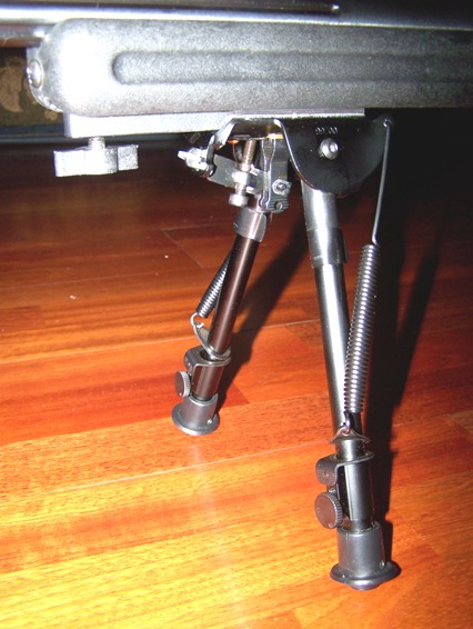

Eye relief can be different from a bench/bipod setup, sets your eye further back. Nice setup and great price on the gun. IMHO you don't need a $$$ scope for range use. It ain't getting wet or dropped on rocks. I found hanging a bipod out front makes closing the action a little weird. Did you?

wreckhog:
It seemed to work for me.
Holds itself open.
Muzzle had good clearance.

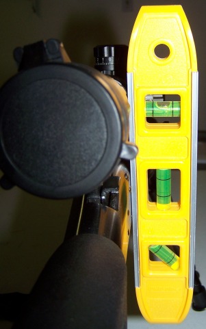

***WARNING***
Make absolutely certain the magnetic strip of the torpedo level is free of debris.
Somehow mine got some debris and while calibrating the B-Square bubble level I scratched the side of the receiver.
In addition, the magnetic strip is not very strong and tended to move around  before settling. I would make sure that I get a level with a strong magnet to avoid moment.
I have used this technique several times without any issues. I bought this level specific for this purpose (never used it for anything else).
I must have placed it on a dirty surface and debris embedded itself in the soft plastic-like magnetic strip.
***Use caution with this technique***
One thing I forgot to mention.
Before “bore” sighting, I vertically aligned the scope’s crosshair and the rifle’s receiver. I attached a magnetic torpedo level to the side of the receiver. It showed when the receiver was vertical:

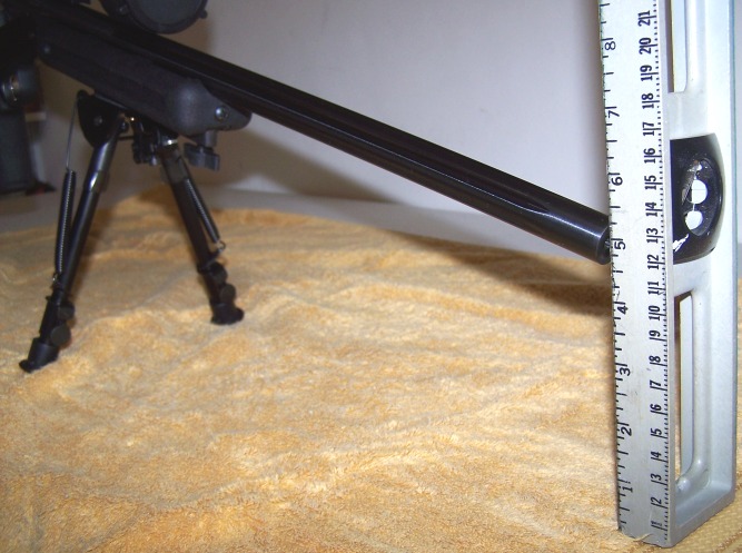

To make the scope’s crosshair vertical with the receiver, with the help of another level, I placed a piece of paper with a vertical line on a wall, about 14 feet away.
With the receiver in the vertical position, I aimed at the line on the paper and rotated the scope until the vertical crosshair aligned with the vertical line on the piece of paper. At that point, I carefully tightened the rings, checking constantly that the crosshair did not shift as I tightened.

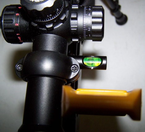

To insure the receiver is vertical when firing, I added a B-Square bubble level that attaches to the weaver mount. As you can see in the picture, the bubble is not level on the white mark, even though the receiver is level (as per the torpedo level):
I will have to tinker with the B-Square level so it accurately shows when the receiver is level.
