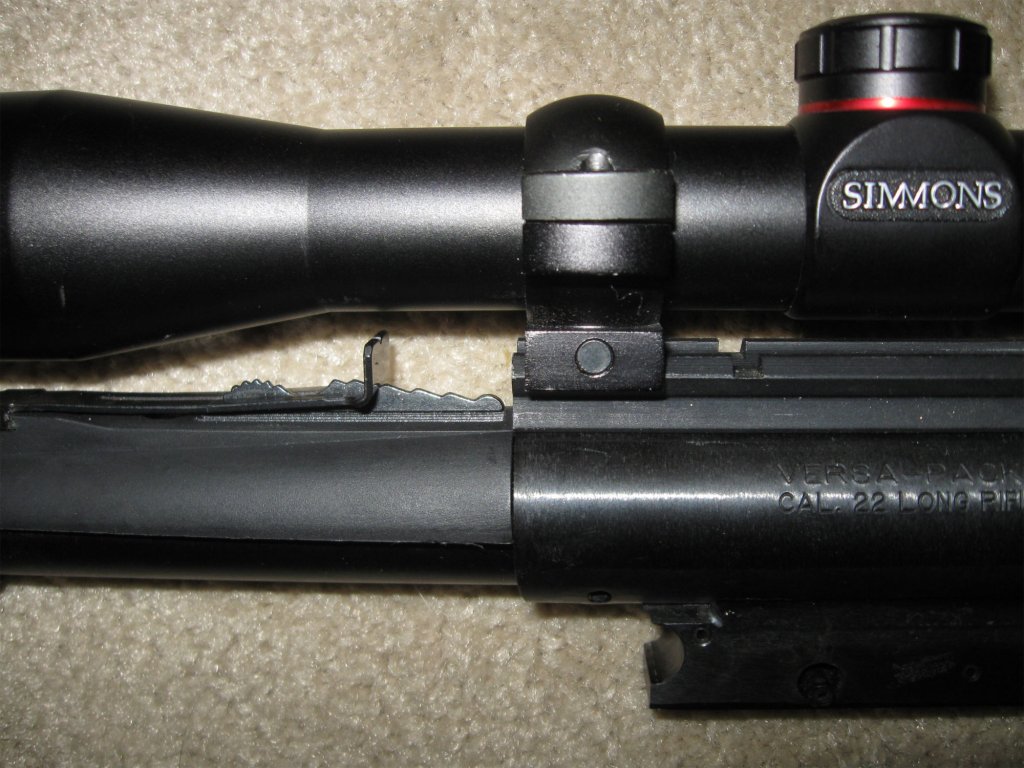

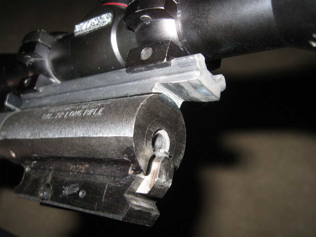

I kinda cheated. I modified a mysterious scope base that I've had floating around in my miscellaneous box for a few years. I drilled an appropriate hole so that I had two holes that lined up with the holes in the barrel. I filed and fiddled with the back end, making an overhang, and used aluminum black on it (see pic - and notice it is not perfectly flat - I'll get around to that later, just wanted to mount the scope and go shoot!). I installed it on my favorite SB2 frame with the laminated straight stock and took it to the range. It shoots like a dream!
Cheers
Kerry
First two pics show the "overhang" - I did it that way 'cause it seemed less hassle than cutting it off flush with the back of the barrel, then making a new groove in the base for the rings. Next is the front end showing the rear sight, and last the VP barrel on the frame with the cinn lam stocks.

  Does the scope work alright ? It looks awfully far back..
Offline tallyho
  • Trade Count: (52)
  • Posts: 1301
  • DECEASED 6/6/2013
Re: scope a versa pack
« Reply #6 on: March 12, 2009, 01:08:28 PM »
Works just dandy for me. ;D The scope has a focusing ring on the eyepiece so I can re-focus for changing ranges... and as an aside, I'm a stock crawler and like to get up nice and close to the scope!
Works fine on a rimfire, but I wouldn't rig it this way on anything with recoil... :o
