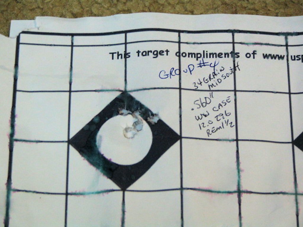

Here is the last target at 50 yards. It started to rain before I got to the target, so the ink ran a little. I wanted to go to my 100 yard target, but like I said I was rained out.
I am getting there. I want to get to 1" @ 100 yards. The front rest was under the fore arm screw. I wanted to do some more experimenting, but like I said I got rained out. I think I am getting close now. I am still getting used to the trigger job, I just did on it; man is it light, but safe. I will start another thread about that. I am still getting used to it.

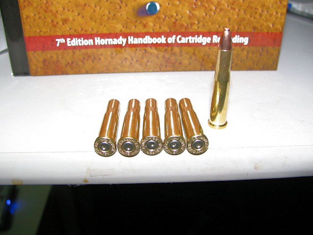

Here is a picture of the cases that shot this group. Group #4
I was running them over my Crony to see how the new loads were doing. The cases do not look like they are over pressure, but the proof is in the chronograph. These were shot out of a dirty barrel and no cleaning between strings. These were 5 shot strings.
Group #1 - Avg 2916 SD 59
Group #2 - Avg 2868 SD 11.5
Group #3 - Avg 2914 SD 27.2
Group #4 - Avg 2958 SD 43.4
According to the Hornady 7th addition 12.0 grains of 296 should get you 3000 fps (H110 - 3100 fps) with a 35 grain V-Max bullet. So I am right in there, about a full pressure load. I am loading out of an old lot of 296, so I have no idea what a new lot will do. I am a little preplexed over the differences in velocity between strings. The SD is is not real solid either, except Group #2 and it also had the slowest velocity average. Group #2 was about 1 1/2", but I blame that on myself, still trying to get used to the trigger.

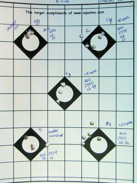

Ok I did some more shooting today. I am not very happy with the group sizes at all. I am still not sure if it me or the gun/loads. These were shot at 50 yards again. I had another gun I wanted to zero and do some load development with too. It is a Savage 221 FB - that is for another thread in another area. The load was virgin WW Cases, 12.0 grains of 296, Remington 1 1/2 primers and Mid South Varmint Nightmare 34 Grain HP. The first string was un-crimped. The next three were crimped.
Group #1 - well you can see :( Un-Crimped
Group #2 - 1st group shot with crimp
Group #3 - Put 3 shots into 1 hole then vertically strung the other two (not sure of order) - 4th shot pierced the primer, but the edges look no different than the rest of the shots in this lot. Velocity on this shot was 2900 fps - 22 fps under the average, but not the lowest in the string.
Group #4 - Had an extra shot due to forgetting to record third shot :-[
Overall I am not happy at all. I think these groups are awful. The only glimmer is the Group #3 that had three go into 1 hole. Maybe it is me too - I am stumped - still searching. There are so many different combinations.
I think I will try some 4227 next. If I do not get any where then maybe switch primers or bullets or both
edit - forgot to mention that the un-crimped string had the lowest SD - 12 go figure
