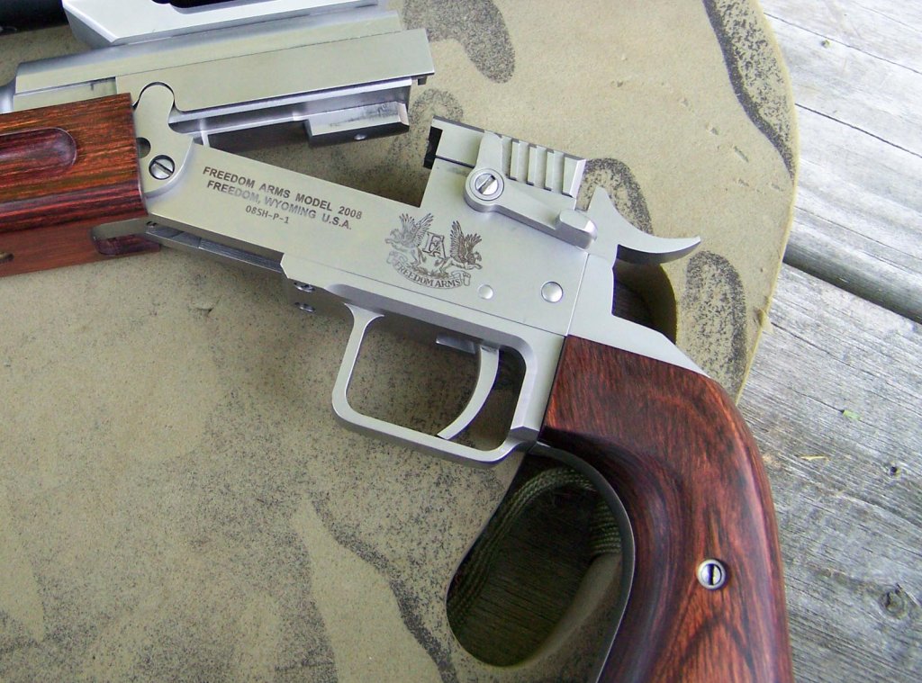

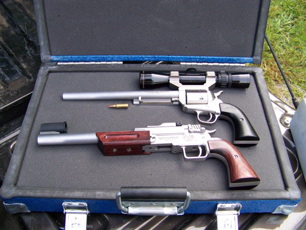

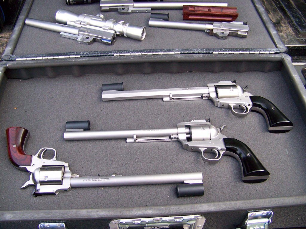

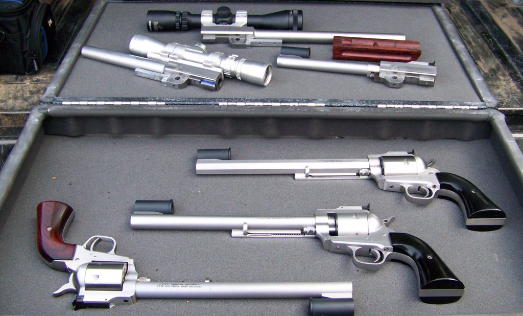

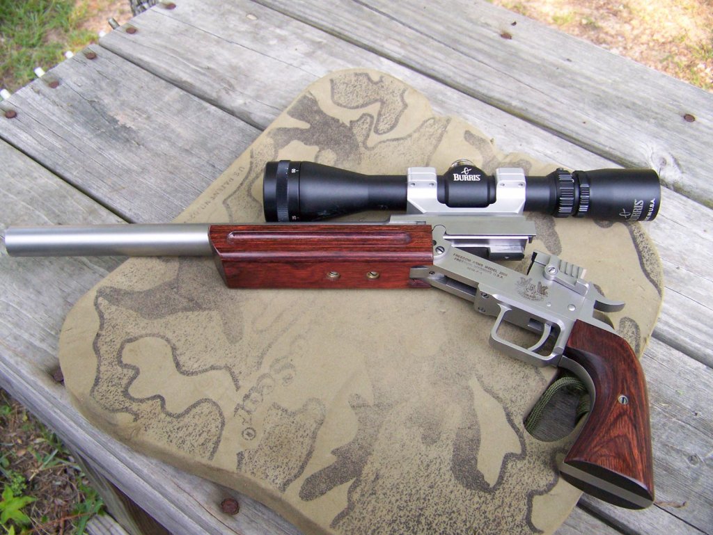

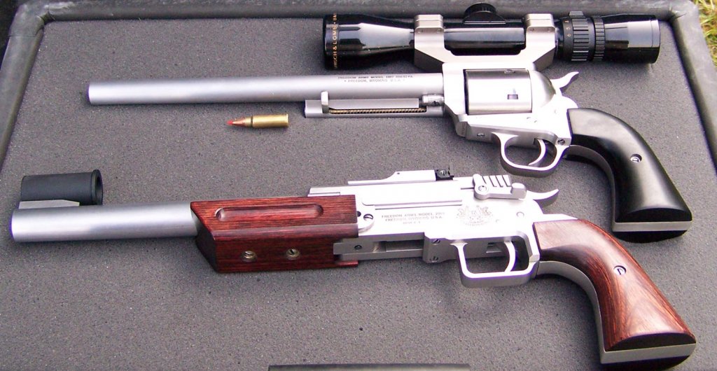

Bob stopped by my house this morning and we visited for perhaps a couple hours. I had the opportunity to shoot the new offerings from Freedom Arms and to take some photos. My photography isn't the best especially with the digital camera hand held but at least it's quick to get on the forums afterward.
I shot the new single shot dubbed the Model 2008 in both .357 magnum and in 6.5 JDJ and also the new version of the FA97 chambered to the .327 Federal necked to .224" using 40 grain bullets from both Sierra and Hornady.
The .357 Magnum barrel was set up for IHMSA competition with iron sights and the other two were both scoped. I shot the .357 at 25 yards only as I just could not see the targets at 100 well enough to even try. I shot both the 6.5 JDJ and the .22-327 at both 25 and 100 yards. I didn't use up too much of Bob's ammo as he is heading out to a shoot from here and lots of folks will want to try them there so I limited my shooting to a few three shot groups. I didn't measure them but they did shoot very well and I'm sure that my shooting skills not the guns limited the groups.

The .357 magnum was pushing 180s about 1400 fps I think Bob said and while I didn't ask I suspect the 123s in the 6.5 JDJ were likely moving about 2300 fps or so. Recoil was very mild from both. The recoil of the 6.5 JDJ should be about equal to the 7-30 but perceived recoil in the Model 2008 was clearly less in my hands than from a TC Contender in 7-30 as that is a combination I have much experience with.

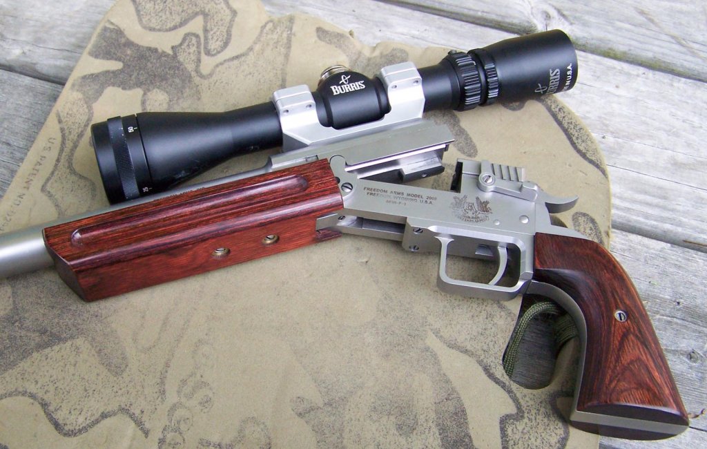

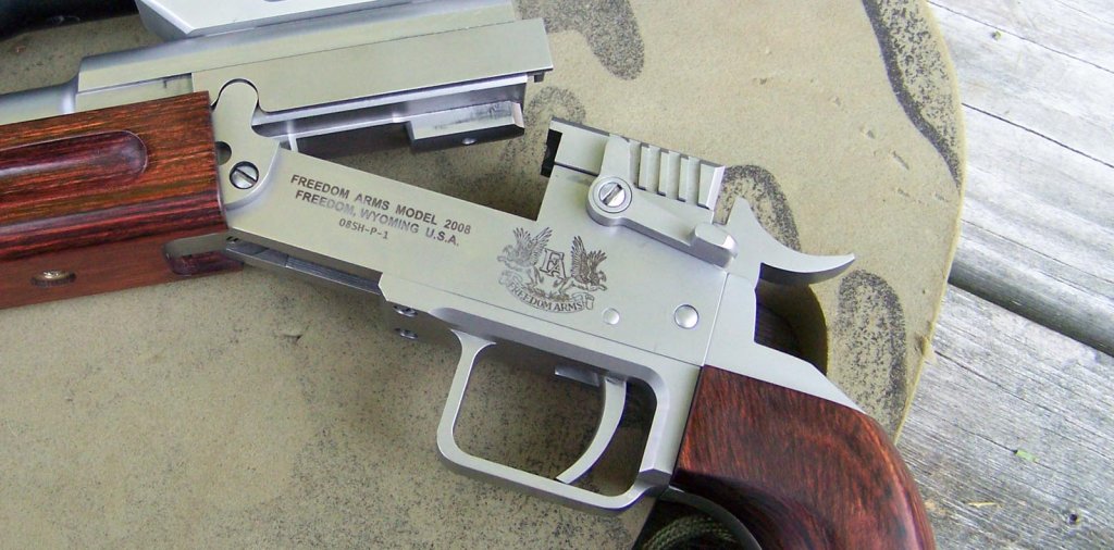

I really like that you do not break the gun using an extention of the trigger guard ala TC as that extention always seems to find my fingers on heavy recoiling rounds. That is not a consideration with Bob's new single shot and even with heavy recoiling loads it's not gonna bite like the TCs do. It opens very easily with the little lever you can see in the photos on the side of the frame. Nice.

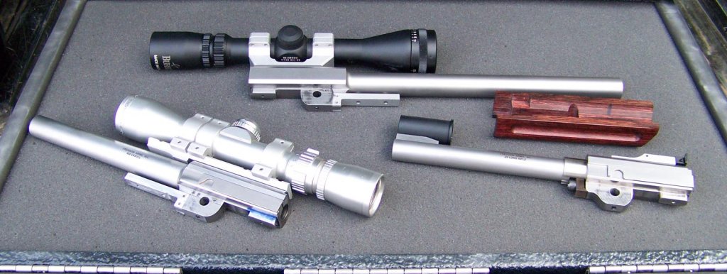

Barrel changing took perhaps a moment longer than on a TC but not enough so that it is that measureable. On production guns Bob said he hopes to have the fore end removable like shotgun fore ends via a push button deal but such things are not as of yet firmed up. For rimfires you buy a shroud that the barrels then fit into. It's kinda like changing out a barrel on a Ruger 10-22 in effect as it has the same sort of attachment as a 10-22 barrel where you remove the screw and the clamp and just pull out a barrel and slide in another. They fit in the shroud slightly off center so the same firing pin works for both rimfire and centerfire. Rimfire offerings will likely be .22LR, .22WMR and .17HMR but he said most likly not the Mach 2 as it seems demand for that round has not really developed as with the .17 HMR.

The new single shot has a bunch of safety features build in. Rather than me try to remember them all we'll wait until Bob has a chance to see and reply to this thread and he can explain them all and answer any questions folks have for him.

That's about all I can think of at the moment I need to pass on. So I'll post the photos and open the thread for discussion and questions for Bob.
