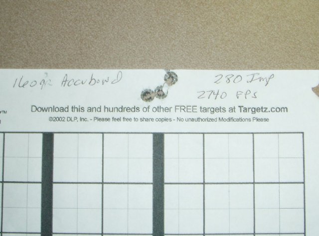

The .280 Improved Ultra shoots the 160gr Accubond real well, a near start load of 58gr IMR 7828 at 2740fps gave me a great little .570” 3 shot group. The data is for a .280 Ackley, but mine is chambered a fair bit larger so I still have a ways to go before reaching the potential of this cartridge.

.280I Ultra looks very good ... you have a good shooter already but you apparently are going to be able to improve upon that ... wow ...
